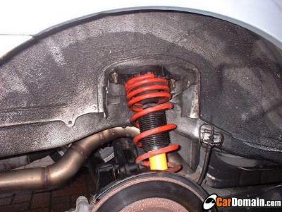

Koni dampers with H&R springs for the P11...
I had these fitted on my P11 GT.The Koni and the H&R go together very,very well.The Konis are adjustable (off the car) for stiffer/softer damping.I had mine set with 1 full click on the back and 1/2 click on the front.This seemed to be the best position for my driving style.
The H&R springs will lower the car between 35-40mm.This is quite a hard ride,but does handle very well and I think it is a good compromise.
I never had any problems with this set up at all and was very reliable.
